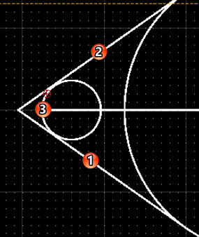

Bildschirmfoto 2019-09-17 um 10.44.08.png (180.35 KiB) Viewed 17531 times
How would I construct the small left circle. In this drawing it is just drawn so lá lá, not precisely constructed
One point is the endpoint of the line. The other two points are the tangent points of the two lines against the circle.
(N.B. the radius isn't known beforehand and the tangent points aren't either as well).

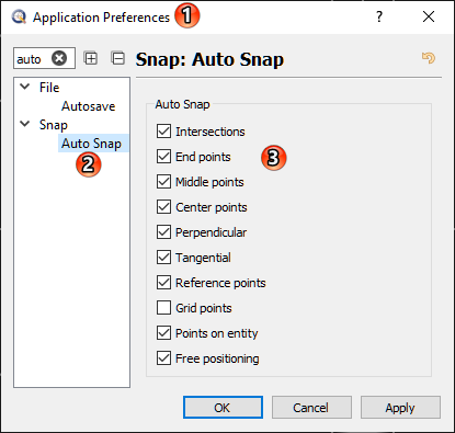

If it still not snap to the endpoint doublecheck your Auto Snap settings. End Points should be checked:

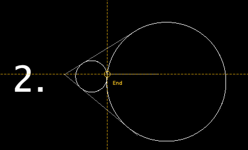

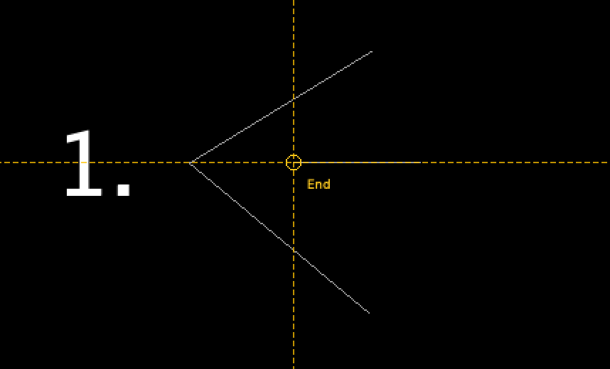

This dxf has two identical situation. Please test on each on them what I posted as solution for this task and tell me how it works for you. Thanks.

e_surprised e_surprised e_surprised
#1 doesn't still work (no solution)
#2 works as expected (found 2 solutions)
Couldn't found any difference between the situations.
What's the reason for that?

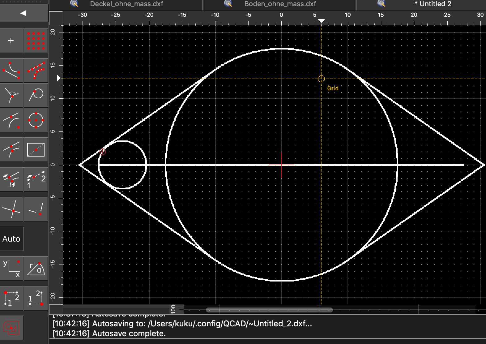

Invoking ct2 on example 1. results in the solution circles disappearing when selecting the endpoint (3.)
Bildschirmfoto 2019-09-18 um 09.22.41.png (18.27 KiB) Viewed 17445 times
Doing the same on example 2. results in showing the two circles for choice end lets choose the desired solution circle:
