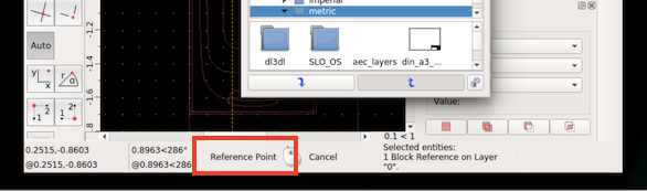

When I select the RH of the two bottom boxes 'create library item from selection' I get no response. I have the proposed block drawing open and the item selected.BTW the video is not of the highest quality, it's just a little difficult to see clearly.

QCAD is asking you for a reference point at that stage:

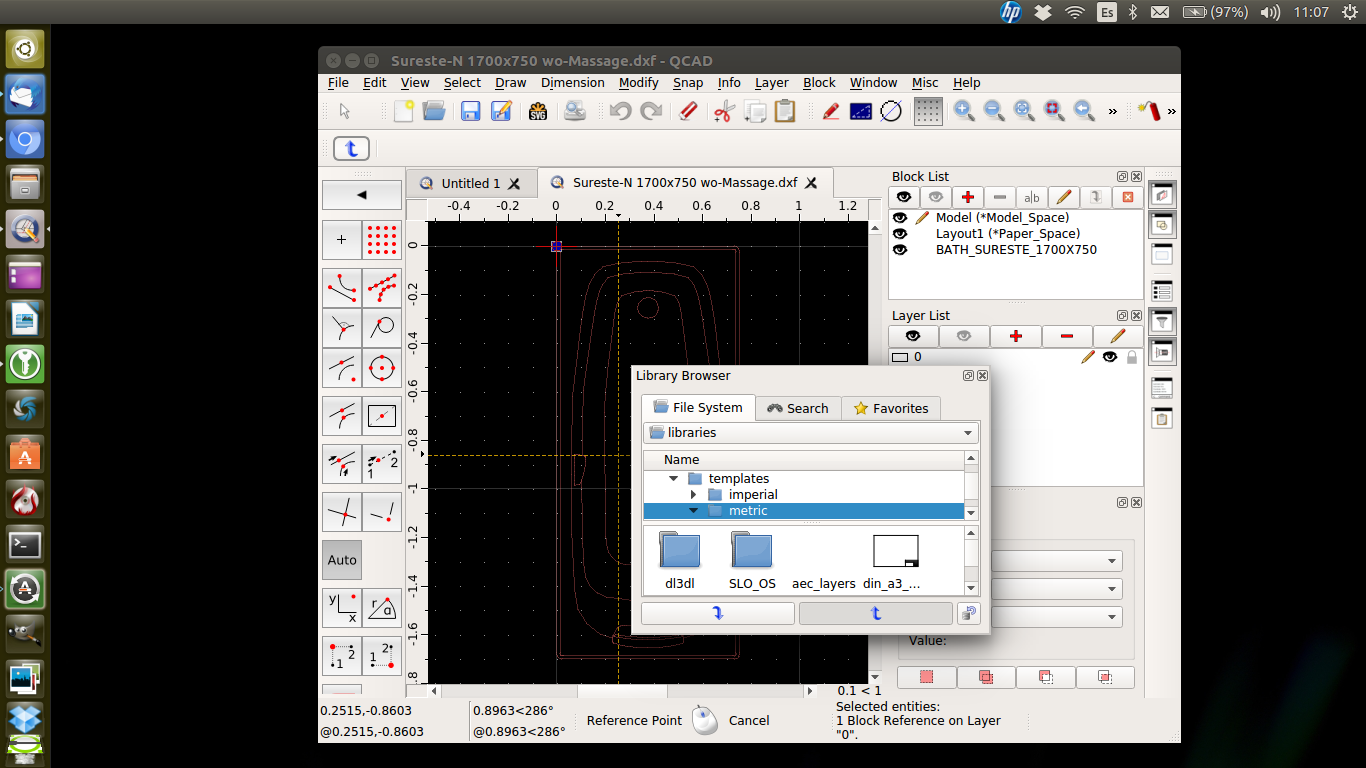

I'm nearly there. I created the Block in Libraries/default/Bathroom Fittings but can't insert it into a new drawing, screenshot below:-
Ray
The block is shown in Block List but doesn't appear under Bathroom Fittings in Library Browser. Ray
- Posts: 8774
Re: Downloded .dxf file, How do I create a new Block?
Try syncing the DB:

Tried via 'Block/Attributes/Synchronise attributes' but nothing happened. Also when I clicked 'Update DB from file system' the Progress window shows VERY briefly showing 0 or 1% then dissappears. What am I doing wrong?

- Posts: 8774
Please check on your file system (e.g. with Windows Explorer) if there's a DXF file under your QCAD installation directory and then "Libraries/default/Bathroom Fittings". If not, you didn't actually create the library item or you might have created it somewhere else on disk.

- Posts: 8774
Your DXF file is saved as:
~/qcad-3.23.0-pro-linux-x86_32/Sureste Bath 1700x750.dxf
While it should be:
~/qcad-3.23.0-pro-linux-x86_32/libraries/default/.../Bathroom Fittings/Sureste Bath 1700x750.dxf
The "..." part is part of your folder structure and unknown to me from previous posts.
While it should be:
