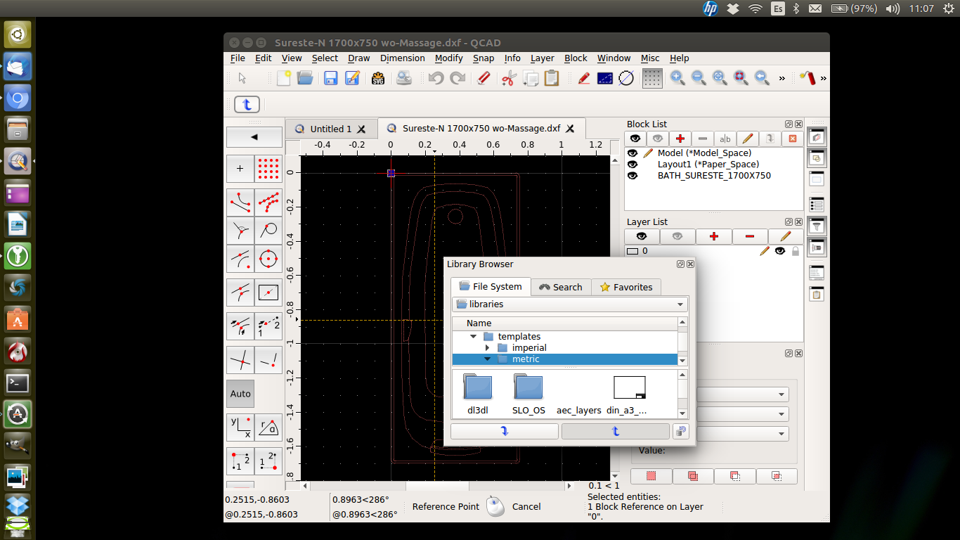

Working through the video I have got to this point:-
Screenshot from 2020-03-18 11-07-24.png (220.65 KiB) Viewed 20657 times
When I select the RH of the two bottom boxes 'create library item from selection' I get no response. I have the proposed block drawing open and the item selected.
BTW the video is not of the highest quality, it's just a little difficult to see clearly.
Sorry that I'm a bit slow in responding to your kind help, but life, under the restrictions imposed by COVD-19, has to go on!
Regards, Ray

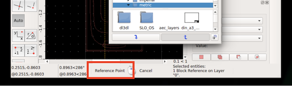

QCAD is asking you for a reference point at that stage:
Screenshot 2020-03-18 at 11.23.05.png (70.17 KiB) Viewed 20655 times

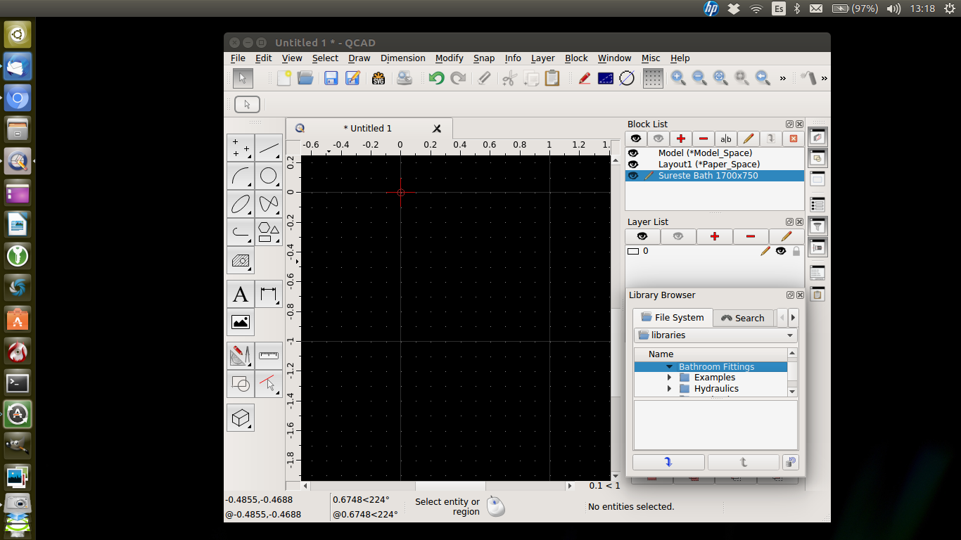

I'm nearly there. I created the Block in Libraries/default/Bathroom Fittings but can't insert it into a new drawing, screenshot below:-
Screenshot from 2020-03-18 13-18-28.png (200.92 KiB) Viewed 20651 times
The block is shown in Block List but doesn't appear under Bathroom Fittings in Library Browser.
Ray

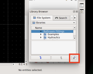

Try syncing the DB:
Screenshot 2020-03-18 at 13.29.37.png (44.49 KiB) Viewed 20649 times

Post by andrew » Thu Mar 19, 2020 2:40 pm
Your DXF file is saved as:
~/qcad-3.23.0-pro-linux-x86_32/Sureste Bath 1700x750.dxf
While it should be:
~/qcad-3.23.0-pro-linux-x86_32/libraries/default/.../Bathroom Fittings/Sureste Bath 1700x750.dxf
The "..." part is part of your folder structure and unknown to me from previous posts.
