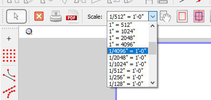

Out of Model_Space Print Preview presents drop down defaults in imperial scales - nice but also expected.
But, scrolling down the list shows scales like 1/4096" = 1'-0". I've never seen those scales in the real world. Just think about this scale - it tells you that 0.000244140625" is equal to 1' ... who works with a scale like that?

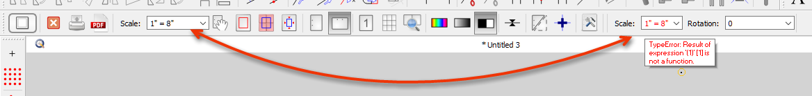

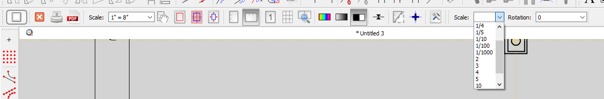

If I add a Viewport the print tools pop up. First Scale option should be the same like that one in Print Preview - but the drop down list is gone - just a metric scale of 1:1 shows up. At least it accepts a manual imperial input like 1" = 8". The other scale option in the tool bar is for the Viewport. Yes, a scale list will be presented but now it's a metric list.
Im pretty sure no one of us will ever work with a metric and an imperial scale in the same drawing! However, smarty pants me - I type in the imperial scale which is immediately declined with the message: "Type error" occurred. Nope, it wasn't a type error the field just doesn't accepts imperial scale formats ...
... but it accepts metric 1/10.

Is the lack of pre-populated common imperial scale options such as 1/4" = 1' in the viewport scale field simply a matter of it not being implemented, or is there more of a purposeful reason for it's omission here? I would think this would be the primary place where someone would choose their scale when placing a viewport in paperspace, so having those common options to choose from like they're already available in print preview would make sense, at least to me. I know with my students last semester, we'd be dealing with 1/4" = 1' or 1/8" = 1' but when they'd place a viewport, they'd have to enter it as 1/48 or 1/96. Of course that's not a big deal at all but I wondered if that is an intentional decision that makes sense beyond my limited knowledge?
Posts: 8777
Re: Printing with imperial scales
Post by andrew » Wed Mar 23, 2022 9:08 am
Yes, this is simply not implemented. I will look into improving this.
No idea. I've never had the pleasure to work with imperial scales, so a bit of help would certainly be appreciated with a list of "acceptable" or "common" scales in the imperial world. Frankly, to me 1/8" = 1'-0" is just as exotic and unthinkable to work with. These scales were suggested at one point by other users.
