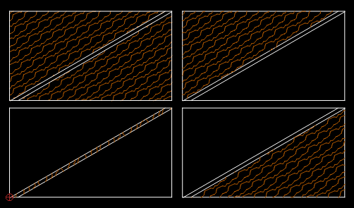

- Posts: 4928
Re: Trimming Objects
Hwrd69,
You didn't mention Hatches before.
Hatches are entities on their own.
From the moment they are created they are unrelated to the shape or shapes or segments that were used to define the boundary.
Hatches areas can not be trimmed the same way as line art.
There is no method to sum or subtract filled areas, or any other logical operation.
They can be Stretched (SS) successful or not depending the nature of the boundary.
The idea here is to create them after you have defined the final geometry.
However, there is kind of another way.
If a hatch would have let us assume 5 straight edges.
Then one could created a regular pentagon, Hatch that, disregard the pentagon and drag the corners of the Hatch.
In this way odd thing can be achieved with Hatches with holes.
Below is one single Hatch entity:

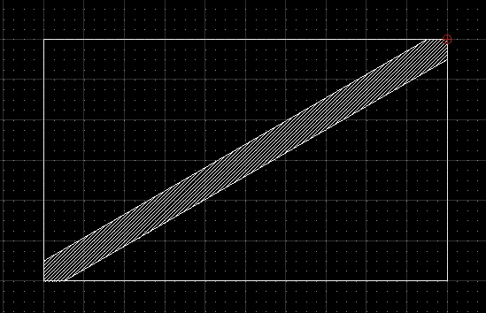

I finally achieved what I was trying to do. I now have to implement it many times over such that I am creating the layout for my wood work piece. I find this method to be somewhat convoluted, but it is what it is.
As you can see below, what I was trying to do was more or less the inverse of what CVH showed me in his example.
I was unable to grab the points/vertices on a polyline so that didn't work for me. I finally laid out the intersections and then redrew the polyline to "hit" the points I wanted to get the shape I desired before adding the hatch.
I guess I will get the hang of it eventually. With enough practice, research, and questions.
Howard
