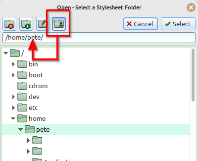

  • A User folder button has been added to the browser, this will fully collapse the current tree and then open up at your User folder.

  • The Stylesheet Information and Shortcuts menu items that were in the Help menu have been moved to the View menu.
  • The default stylesheet has been changed from monochrome to coloured.
