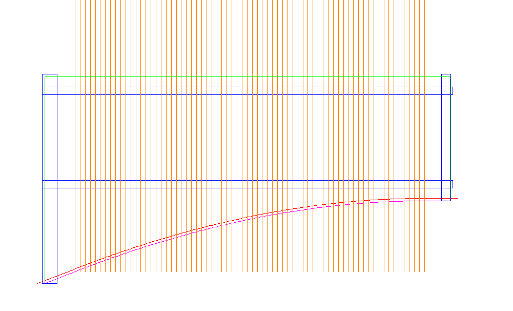

Is there a feature in QCAD that can 'bulk' trim lines similar to the trim feature in VCarve Pro? See below:
Bulk Line Trimming.gif (169 KiB) Viewed 11368 times
As you can see, this saves a lot of time in trimming lines like this.

You can use Modify > Break out Segment with the Line Selection Mode to trim away all the segments intersected by a line. The line is indicated by its start and end point.

Perfect! Thank you Andrew
