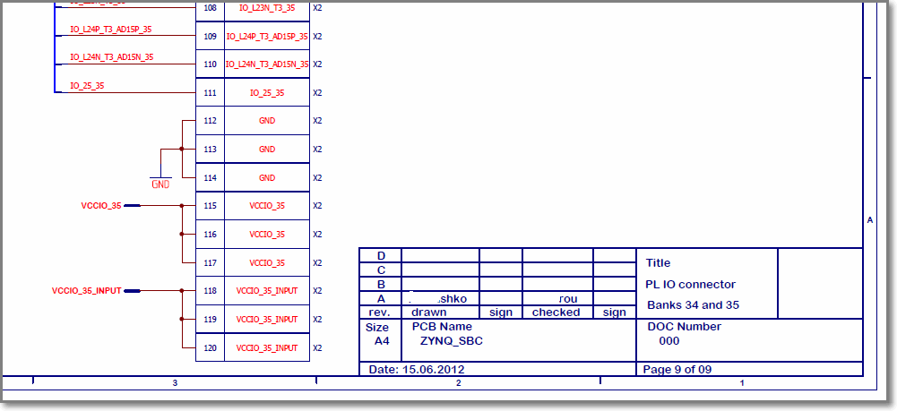

On printouts I would need a legend, which contains important information about the drawing like:
- Company
- Author
- Review
- Date
- Time
- Title
- Subtitle
- # Page and total number of pages
Right now I have only example from PCB Schematics, but the idea is the same:
Further you see in the example another thing: A paper margin drawing, which is counting sectors. This is very useful, if you send you print outs to any other person. When discussing the drawings, you could say e.g. "...look at section A-3, there is the part, which I am talking about..." I do not know, if such thing is common for CAD, I know it only from PCB design

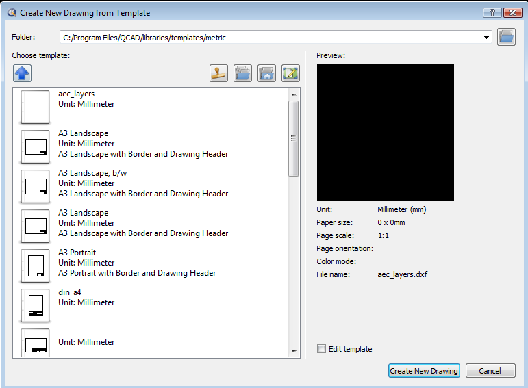

There are a number of Templates submitted here on the forum:
viewforum.php?f=51
You can also create a new drawing from an existing template from directly within QCAD (Main Menu > File > Create Drawing from Template), is this what you meant here?
viewforum.php?f=51

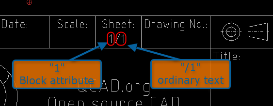

- Posts: 5054
Re: Generate automaticall Legend at PrintOuts
Hi everybody!
The solution could be:
- define the actual page number as a "Block attribute",
- define the "number of pages" as an ordinary text (same font, same size etc etc as the page number) maybe something like "/1",
Now you can maintain all page numbers within the Block attribute management (Property editor),
If you have to change the total Page number in the end of the project - like 20 instead of 1 - you have just to use the QCad tool "Find/replace (Ctrl+F)",
Search for: /1
Replace with: /20
... done!
Yes .... estimated time to do that .... around 5 seconds!rrauch wrote:Assume, when I have a huge set of drawings, maybe 20 pages... and in a new version, I add a page. do I need to edit all pages to change the displayed total number of pages?
Search for: /1
Replace with: /20
... done!
