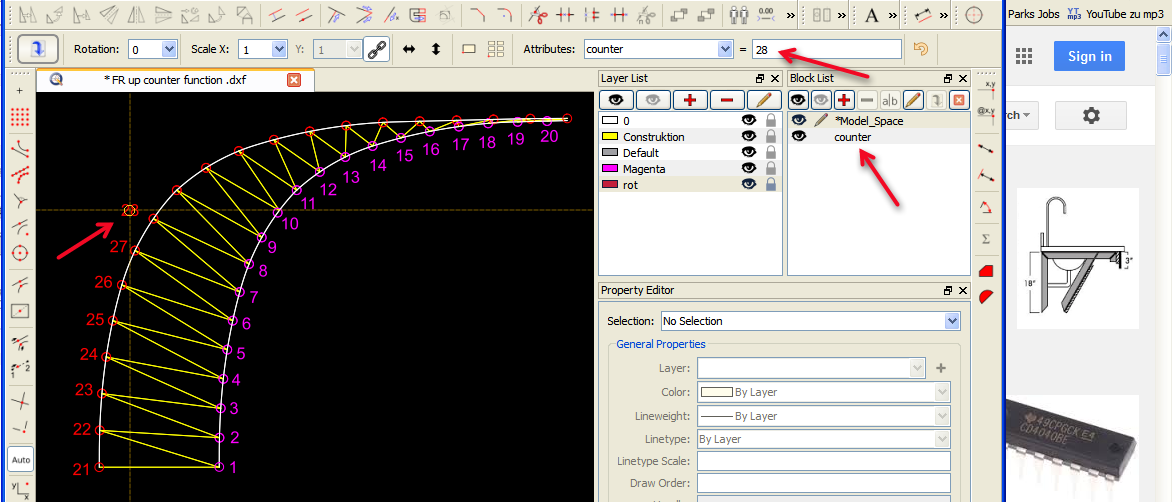

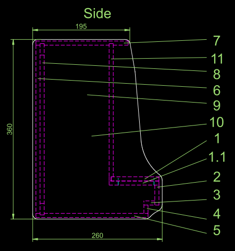

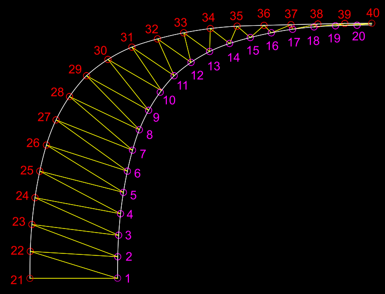

I find myself often in need to use consecutive numbers for any kind of labeling in my drawings. E.g. in drawings with flat pattern to keep track on the next step or for drawings with many detail views, scale views etc. etc. etc.
For this purpose I can use in QCAD the Text tool or the Block Attributes.
Both methods are working regarding this issue on the same way.

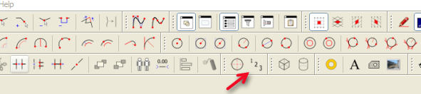

I remember when drawing architectural plans I used to have to number all the rooms, doors and windows, and some other things also. This would have been easier with a tool like this, so I decided to have a go. I have called this tool 'Counter'. You can start it with the commands 'counter' or 'c12' in the command line, or use the shortcut 'c12'.
The tool has four options, 'Start', 'Incr.', 'Prefix' and 'Suffix'.
The 'Start' box contains the start number, the 'Incr.' box is the amount to add to the start number each time you click a position. This can be positive or negative, so you can count up or down. The 'Prefix' box contains text which will appear before the number, and the 'Suffix' box contains text which will appear after the number. When the tool starts you are prompted with 'Position'. You then pick a point for the text, and the start number is changed to the next number automatically. So you can click, as many times as you wish. When you exit, the command the tool remembers the contents of the boxes.

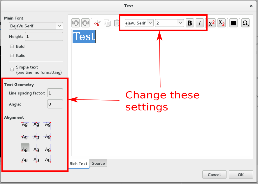

Now you may wish to change the font, angle and height of the text. To do this, use the 'Text' tool to set the options for the text.
As you can see from the picture you can change the Angle, Alignment, Font, Height, Bold and Italic options. (Changing the other options will have no effect). You can use the shortcut 'TE' to start the text tool while in the counter command. When you press the 'OK' button the settings are saved to the configuration file, which this tool then uses those settings. When the text tool prompts you for a position, press the right mouse button or press the 'escape' key on the keyboard, to exit the command. You will then be back in the counter tool.

I have attached a zip file containing a directory named 'Counter'. Extract this directory and place it in the directory 'scripts/Misc/MiscDrawing'. I have placed it here because it is not a standard feature of cad programs that I have used (although you might like to argue that it should be). The menu entry is 'Misc->MiscDrawing->Counter'.

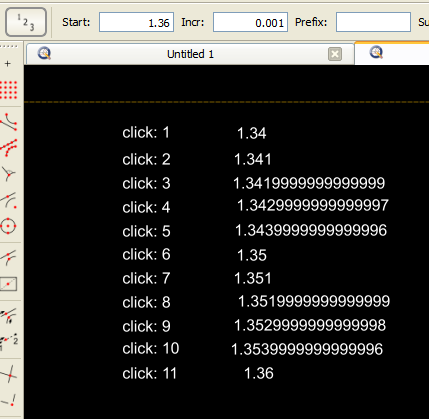

If I put a (e.g.) 2.1 in the "Start" box and need to have a 0.1 in the 'Incr.' box to get at the next click a 2.2 the Counter will spit out an unexpected number with the third click ...
Could that be fixed?

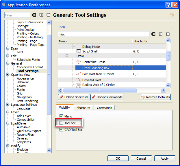

J-J wrote:That's what I did at first, but since I do not need the other tools that often ...
Me too! I've just disabled all "unwanted" tools and have never to deal with them again on the screen - until I change my mind ... :wink:
Good point, I forgot about that :oops:

But I'm still facing problems with crazy numbers - maybe the tool should be limited to reasonable terms, I don't know ... :oops:
Start: 1.34 / Incr: 0.001

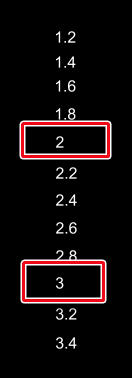

However - one more question: If I need to have a numerical series like this ...
... do I have the power to tell the tool that I need to have the 2 and the 3 displayed with the zeros? Therefore 2.0 and 3.0 instead of 2 and 3. I played around with the Dimension Settings but without any luck ...

Husky wrote:But I'm still facing problems with crazy numbers
I tried this on my computer, and it worked fine. On further investigation this appears to be a problem of precision. I set my precision from 4 to 2 decimal places, and I got the same crazy numbers as you. If you are using an increment of 0.001 you need to set the precision to at least 3 decimal places. So go to 'Edit->Drawing Preferences -> Dimension->Dimension Settings' and set a suitable precision. I keep mine set to 4 decimal places for linear dimensions and 2 decimal places for angular dimensions. Give this a go and let me know if this fixes it.

I have made a very small change to this tool, so now if you switch on 'Show trailing zeroes' and set the precision to 1 you will see a zero at the end of a number:-
1.0, 1.2, 1.4 ... 1.8, 2.0, 2.2 ... 2.8, 3.0 ...
For more decimal places set the precision to the number of decimal places required, and switch on 'Show trailing zeroes'. So for your example 1.34 set the precision to 3:-
1.340, 1.341, 1.342 ... 1.350, 1.351 ... 1.360 ...
