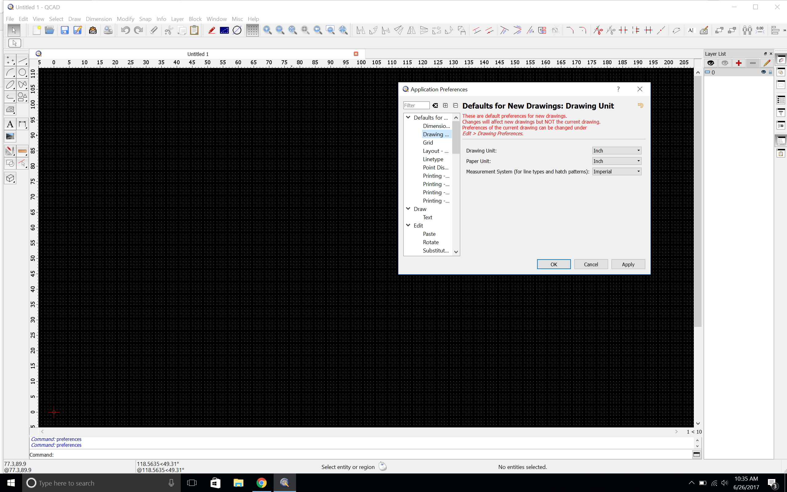

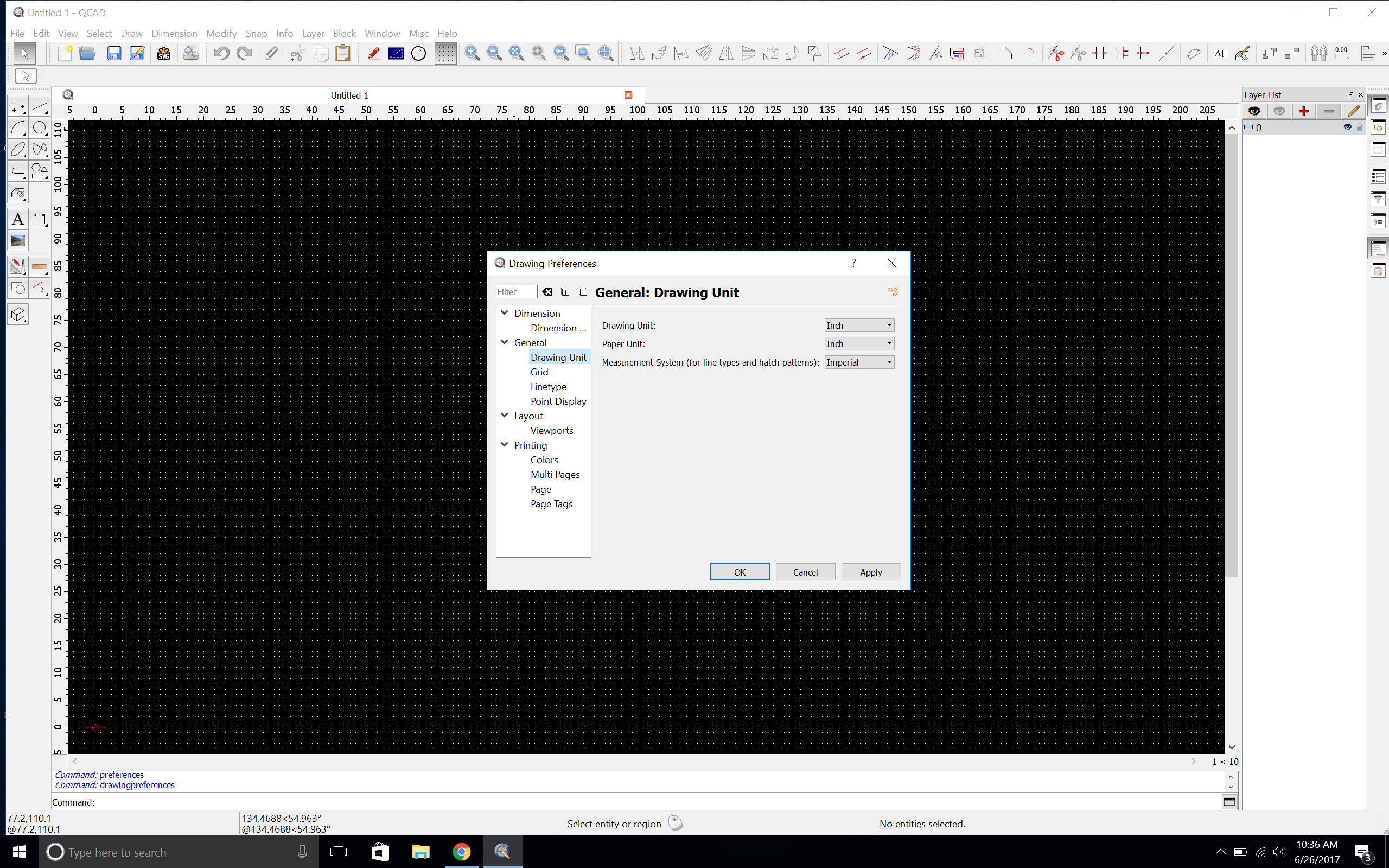

For some reason MM won't change to inches even though it's set up properly in the Application preferences and the Drawing preferences. Am I overlooking something? My understanding is that it's supposed to take effect once I change the settings and open a new file, yeah? I understand it won't influence my current drawing.
Using WIndows 10 with QCAD Pro.
Any help is appreciated, thanks.
Attached photos just in case.

Re: Changing MM to Inches
The unit you set up has no visible effect on your drawing. It simply means that one "drawing unit" is now meant to be one Inch.
Perhaps you are trying to change the number format? You can find that under Edit > Drawing Preferences > Dimension > Dimension Settings > Label Format > Linear Dimensions > Format.
