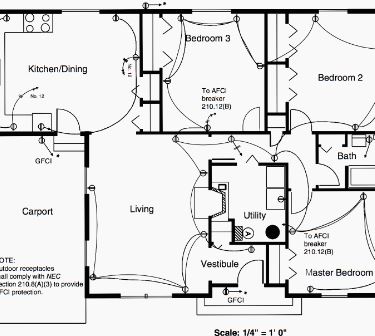

What Qcad tool is used to draw Residential Electrical wiring (the curved line that goes from one outlet to another and or switches, etc) and where to get Symbols residential architecture. ie outlet, switches, fans, etc? See attached example of drawing cured lines and symbols.
Thanks, Danny operating windows 7 64bit Qcad Pro Version: 3.21.3.0 (3.21.3)

I would probably use the "Spline (Fit Points)" tool. An open Spline desidned with three points should do it. And it is easy to edit ...
Symbols: You can download free Part Libraries directly from QCAD https://www.qcad.org/en/qcad-add-ons or search the internet for 2D dxf / dwg Symbols.
- Posts: 8772
Re: What Qcad tool to draw Residential Electrical wiring and where to get Symbols?
Please check out the tutorial Working with the Part Library as well.
