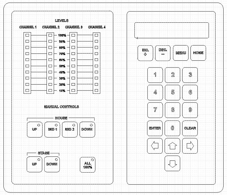

I will often get a drawing from a manufacturer of their product so I can place it into a drawing. More often than not, these drawings will consist of a lot of splines to make their shapes.

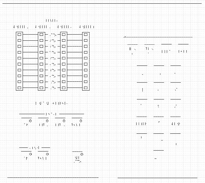

Now, when I open them, they look fine. I can copy and paste them without issue (within the same drawing or copy them into a new drawing). Everything looks great...until I open that drawing again. At that point, a large portion of the splines are gone so the image looks mostly gone too. This is platform independent (I've tried it on Mac and PC) and on the current version of QCAD too.
Now, by experimenting...if I "Explode" the splines and configure the Explode Splines to Polylines, then I get a version that can be saved. Is that normal?
This is what the control panel looks like when I open the manufacturer's file or when I copy about:
Here is what it looks like after saving and reopening:

And here is what happens to it after it is saved (dxf or dwg, it doesn't matter):
EpradControl.dxf
(1.17 MiB) Downloaded 748 times

The splines which are causing the issue are built with Degree 3 splines. It is difficult to select them with the mouse ...
However - if you change the degree to 2 the drawing can be properly saved and will load again without missing entities. After that you can change it back to degree 3 and it is still working ...

Unfortunately, this is an issue with the OpenDesign libraries (19.x, 20.x). I've reported the issue and hopefully they will provide a fix or a workaround.
As CVH has pointed out, the Windows 32bit package might be a workaround for you at this point as it still uses the OpenDesign libraries version 4.
Note: These are splines that cannot be produced with QCAD itself (with clamped knot values or "corners" in the middle of the spline).

I've reported this to OpenDesign and they confirmed the bug. For now, we'll roll back to OpenDesign 4.x where possible.
