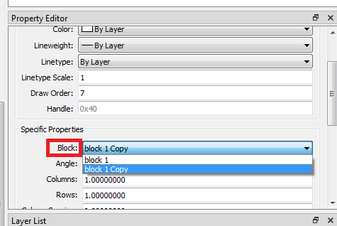

Posts: 4891
Re: Save block under new name
Post by CVH » Thu Dec 03, 2020 4:13 pm
Rantanplan7 wrote:
Thu Dec 03, 2020 3:09 pm
Next is to insert this dupblock7
4- Select the Block reference refering to the old copy.
5- Select another blockname for the Block Specific Property in the Property Editor.
Post by Husky » Fri Dec 04, 2020 12:42 am
@Rantanplan7
Given situation: Two or more library blocks of the same kind (lets call it block7) on a complex drawing and I want to make changes to one of the three.
I duplicate the block and rename it (lets call it dupblock7).
Correct.
Now I get a new entry in the block list - dupblock7.
Correct.
Next is to insert this dupblock7 into my drawing, but on spot at the position of the block7 I wanted to change.
No, follow CVH instruction and use the Property Editor.
To keep things simple I have to insert the dupblock7 on a different layer, ...
Replacing the block within the Property Editor offers also the possibility to change the layer at the same time.
