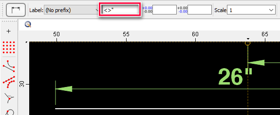

use for the Unit "inch,
Label Format "Fractional"
When you now launch a DIM tool make sure to put into the option bar a <>" for Label,
You are also able to change the Label afterward with the Property Editor. Select in that case all DIMS and type in the Label field <>".
