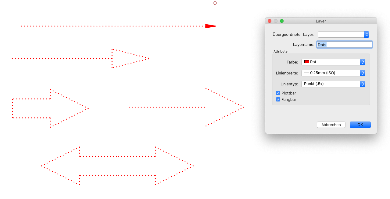

Why don't you create your own dotted arrows?
It's very simple:
1. Create an arrow (perhaps make a block of it)
2. Create a layer with desired color, width and type
Thomas
dotted arrows.png (112.42 KiB) Viewed 49267 times

I know that was possible in AutoCad, but I can't see a way to replace the arrow or tick in Qcad with a block. And I didn't mean a dotted arrow, I meant a circular filled dot as in the attached.
