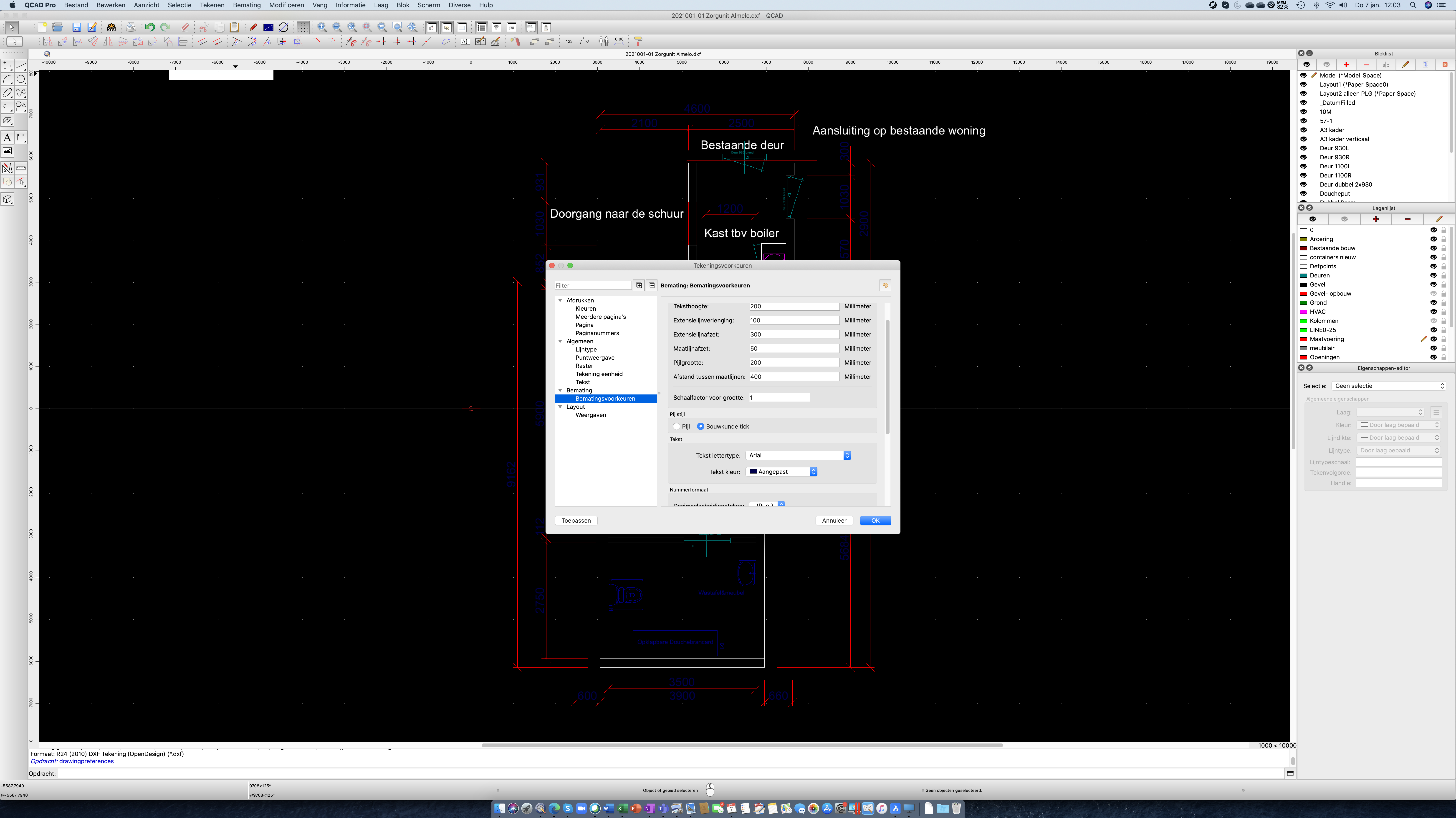

I have a question about the color of the dimensions. After opening the file it’s always dark blue (aangepast) instead of black/white (zwart). I always must change it manually. Then it stays until I close the drawing and open it again.
Do you know what to do to keep the color of the dimension text always the same (black)?
I also send you the dxf file so you can try it.
Thanks in advance for your help.
Radek

Can you try setting it to "White" instead? It will still be displayed as white in model space and black when printing.
The color "Black" seems to be skipped by the OpenDesign libraries on saving. It's then reversed to the default color (a dark blue) on the next loading. I will look into this but fear this might be a DXF/DWG format limitation.

andrew wrote: ↑Thu Jan 07, 2021 1:23 pmCan you try setting it to "White" instead? It will still be displayed as white in model space and black when printing.The color "Black" seems to be skipped by the OpenDesign libraries on saving. It's then reversed to the default color (a dark blue) on the next loading. I will look into this but fear this might be a DXF/DWG format limitation.yes- white helps! Thank you
no prob. I think it's solved now. Thank you
