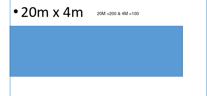

This may seem like a silly question.
I am meant to be using a scale of 1:50.
This was where I started off from needing as a perimeter to work within.
Where I am now below !
With 100 instead of 4M, and 200 instead of 20M
How do I correct this where the dimensions show as true to scale in numerical Meters ?

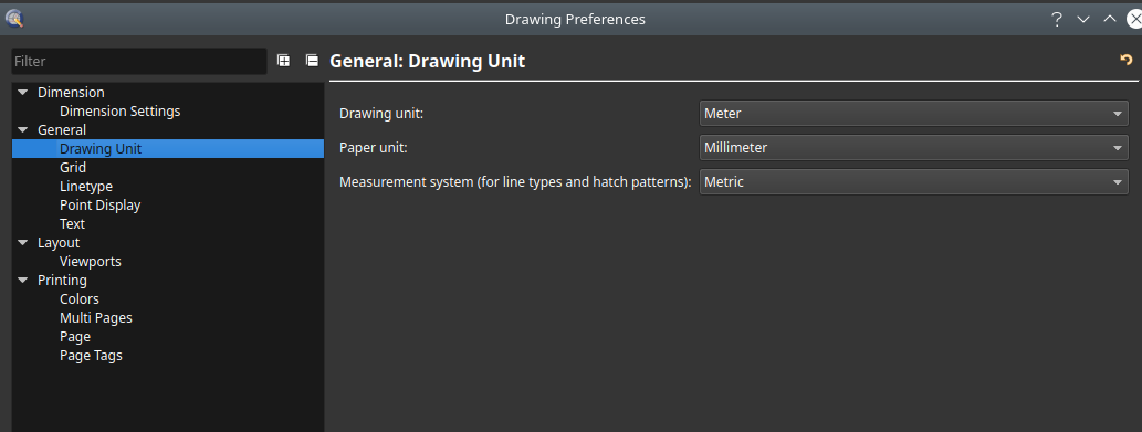

Prefs:
Units:
Thanks,

Odd scaling:
20m = 200 => 1unit = 1dm
4m = 100 => 1unit = 4cm
What is drawn is an outer contour of 200m by 100m
and an inner of 120m by 20m
What is 6 times 20m and 5 times 4m!?

I did not pick the site measurements or the scale ! I think the 1:50 scale was to make readable on a printer out A3 page.
I there any way I can re-jig this to give correct dimensions in Meters,
and if printed out on an A3, a person could put a scale ruler to it ?
Maybe I started off wrong in the first place, in the settings ?
Any thoughts ?
Thanks.
Any thoughts ?
Thanks.

1:50 usually denotes the paper scale: 1unit on paper is 50units in real world.
That is a uniform scale in both X & Y and is set at paper level.
For technical drawings we use mm as drawing unit.
In landscaping it is common to use cm or m as drawing unit.
Again, as answer to the topic title:
How dimensions are displayed can be set by their linear factor property.
Units can be added in the label property.
Assuming that you are using meters, then 20 by 4 meter is simply 20 by 4 units.
In cm that is 2000 by 400 units, In dm 200 by 40.
And always long and narrow as 20 by 4 m is 5 times longer as it is wide.
On paper, in mm, in 1:50, that would be 400mm by 80mm.
What is indeed about as long as an A3 (95%), but also only 27% of the paper width.
(Probably too long if one consider paper borders.)
200units = 20m (10:1) & 100units = 4m (25:1)
Using a non-uniform drawing scale is rather odd. (Not that it can't be done.)
