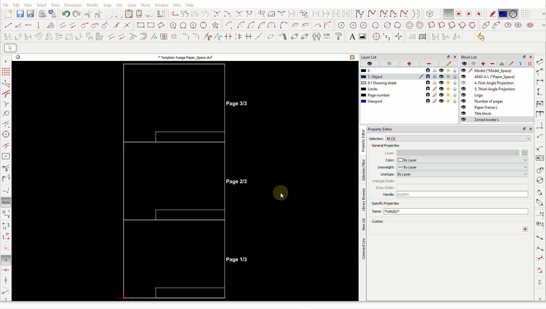

The template I speak of is a mostly cookie cutter drawing frame, which consist of our company name, the drawing authors name, current revision, page number, and an open area to place elements designed in other blocks. All models are designed in the model space, then a viewport is added to show the model in the paper space. The template allows our drawing to be printed on 8.5x11 pages. Our drawings also include additional information such as assembly instructions and tables that are created in their own block an inserted into the paper space from the block list. Often we are not able to fit all elements of the drawing into a single page and another page will be added. I am hoping to have our blank drawing frame on all new pages of the paper space.
Unfortunately it is against our company policy to export DXF without direct approval from upper management, if this can be avoided I would like to not involve them at this time. I have attached a picture from the QCAD tutorial website that looks very similar to our drawing frame.
My goal is to be able to be able to add another page to my paper space using the multiple pages menu, and have our drawing frame shown on new pages, instead of manually adding our drawing frame from a copy saved in our library. The page numbers updating on their own would be a bonus, however I understand this may not be able to be automated.

Ok, as a start point ...Jash wrote: ↑Fri Jun 18, 2021 2:50 pmMy goal is to be able to be able to add another page to my paper space using the multiple pages menu, and have our drawing frame shown on new pages, instead of manually adding our drawing frame from a copy saved in our library. The page numbers updating on their own would be a bonus, however I understand this may not be able to be automated.
Create a drawing template with all basic layer and blocks like my example. This template can be used directly as a default template (Menu / File / New) in QCAD Pro or also as an separably loaded template.
Structure:
Create all basic layer which should be used for new drawings.
Create one layer for "Number of pages". This layer will be used to tell the total number of printed pages.
Create all blocks for title block etc etc.
Model_Space: Rectangles are used to have a limited area for new drawings. They are not plottable. If you like to place standard Viewports - that is possible too but depends on the drawing typ. For my example drawing I placed already the Viewports.
Paper_Space: Set up 1-X Pages with drawing frame, title block etc etc. My example assumes that the drawing could consists of 1 to 3 pages.
Design the drawing. If your drawing exceed one page use the next limited area for a second page. In my case I needed two pages.
Switch to Paper_Space. Note: QCAD will only print areas which are covered by white page(s). Everything else will be ignored. In my example I set the Multi page setting to two.
Edit block "Number of pages". This block has only one number. It is used to complete the Page statement. Static text in Paper_Space for "Sheet" is 1 / , 2 / , and 3 / . Changing the block with the actual page count will complete the statement to 1 / 3, 2 / 3 and 3 /3. I agree - it is not automated but it works ...

Husky wrote: ↑Sat Jun 19, 2021 9:16 amSwitch to Paper_Space. Note: QCAD will only print areas which are covered by white page(s). Everything else will be ignored. In my example I set the Multi page setting to two.
Yes... this is great. I had not considered to just have the drawing frames present on the paper space. This will totally eliminate the possibility to misplacing additional drawing frames.
Really appreciate you taking the time to help me out, Husky!!
