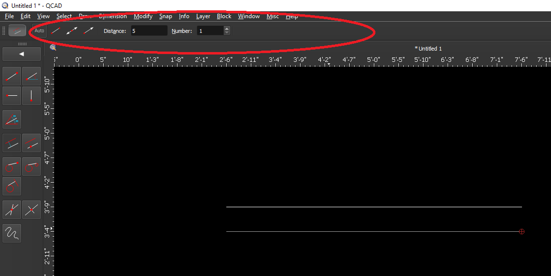

2. What's the secret using offset and parallel with dimensions? It always offsets 1 inch.

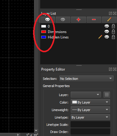

3. Why doesn't the layer box show the color and line type?

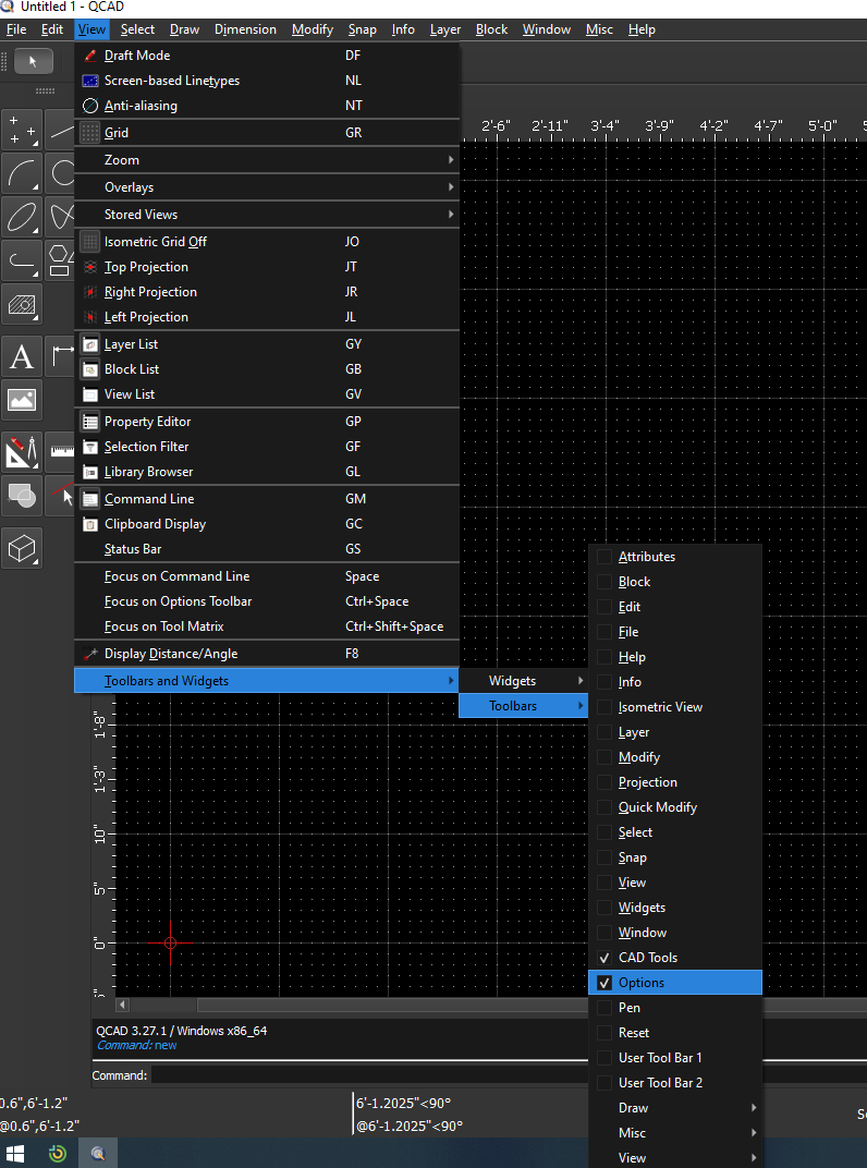

2. When using the parallel and offset tools, and many other tools, you should see the "options toolbar" at the top. If not, you can turn it on. Take a look at the 2nd image below.
3. The layers widget does show the layer color, however, you are correct that it does not show the linetype.
