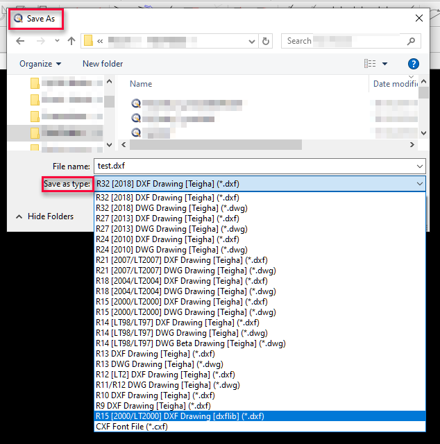

As for the Layer 0 not printing I never had this problem with the free version of Qcad which saved only in R15 [2000LT2000] DXF Drawing [Teigha] (.dxf)
I wanted to save in this version by default but the professional version only allows you to set your default format to as far back as
R18 [2004/2004LT] DXF so what I did was edit Qcads config file and changed the following:-
Copy and paste this into SaveAs part of config file:
Filter=R15 [2000LT2000] DXF Drawing [Teigha] (.dxf)
Most of my customers use AutoCad and to have them call me and say they had to edit all my dxf files because they couldn't print them
was slightly embarrassing.. So now my files all save as R15 [2000LT2000] DXF Drawing [Teigha] (.dxf) by default
by the way the config file is in the %appdata%\Roaming\Qcad "Folder"
I set mine to read only after the edits as I have Qcad setup as I want it now..
I hope this helps someone out there who is having trouble with printing compatibility with AutoCad..

John Hyslop wrote:
Sat Oct 19, 2019 4:58 am
Properly there is a reason not to offer anymore a 20 year old version .... :wink:
Howsoever - you are still able to save a drawing in an old version (even R15) within the "Save As" dialog ...
... and for obvious reasons I do not recommend to edit the config file manually.

Post by John Hyslop » Sat Oct 19, 2019 12:45 pm
Hi Husky
Thanks for the reply ...
Version 2000 DXF is the only version that prints from autocad layer 0 set to white as default..this is the only reason I've set it as default..I know you can save as ver 2000 but if I forget it doesn't print... don't get me wrong here I think qcad is a brilliant program.. I've used autocad for over 30 years and now switched over to qcad professional version...I only use for 2d for 3d I use Autodesk Inventor...As for the configuration file if for some reason you happen to make a mistake you can simply delete it and qcad will create a new one on next startup...all you need to do then is setup all your preferred settings again..
