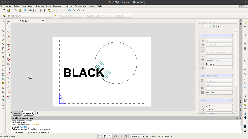

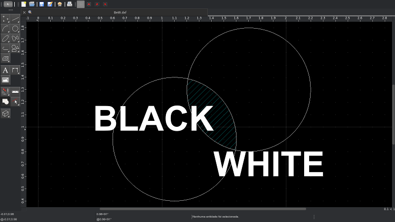

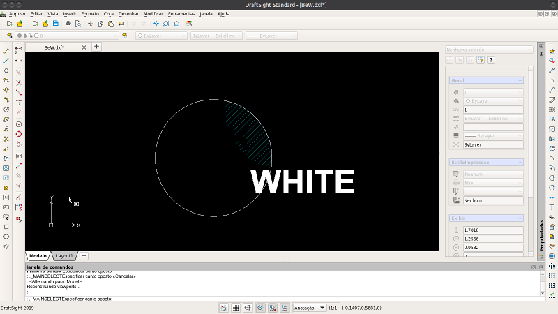

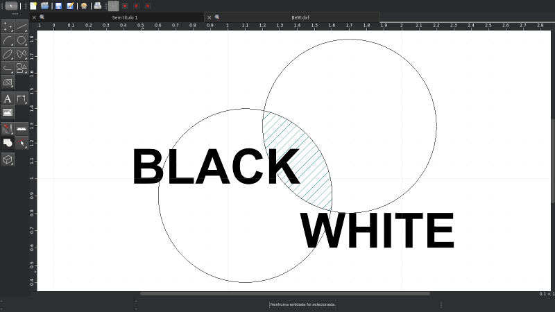

JoseVieira
- Posts: 14
- Joined: Sun Jun 30, 2019 11:35 pm
Re: Black and White color
Hi! I,m back.
Thank You, CVH.
I'm working at QCad using black and white colors successfuly, without any trouble shooting. The problem becames when somebody else opens files that I've criated at QCad on their own software, like AutoCad or DraftSight, and they can't see the black lines over a black background.
That's the problem - compatibility.
The good news:
I did note that LibreCad features a Black/White color, instead of Black color and White color, and that works well when we open a LibreCad DXF file at others CAD soft, like DraftSight.
LibreCad seems to understand Black/White color from QCad files, but that's an ilusion. Actually, it converts QCad's Black color to B/W color and QCad's white color to a bright gray that looks like white when over a black background and are still visible over a white background.
As LibreCad is a fork from QCad, I think that introducing Black/White color for QCad should be easy.
Thank You, CVH.
The good news:

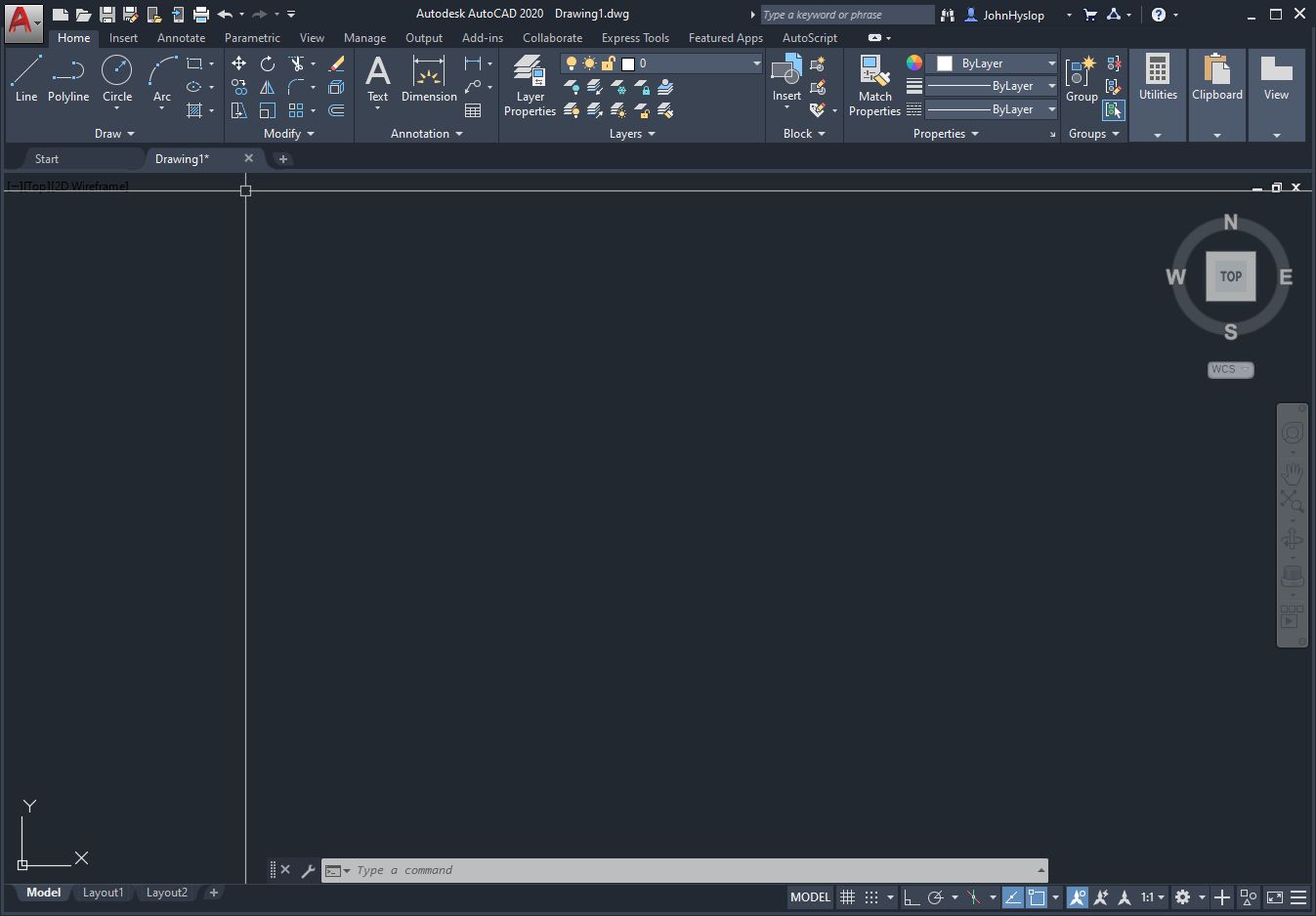

PS Just to make things harder AutoCad Changed there default background colour
to RGB 33,40,48 ( a very dark black with a tint of blue and grey ) see screenshot
2020 AutoCad still uses Index 7 white for layer 0
It would be good if Qcad could imulate this too for
versions up from R15 [2000] dxf
Fingers crossed it will be worked out soon... meanwhile
I'll stick to saving as R15 it suits me and all my customers
who use my files for lasercutting.. even when i was using
AutoCad 2020 I still saved as ver 2000 dxf just for older machine
compatibilty..
Thanks Again for the info
